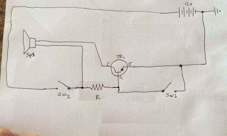

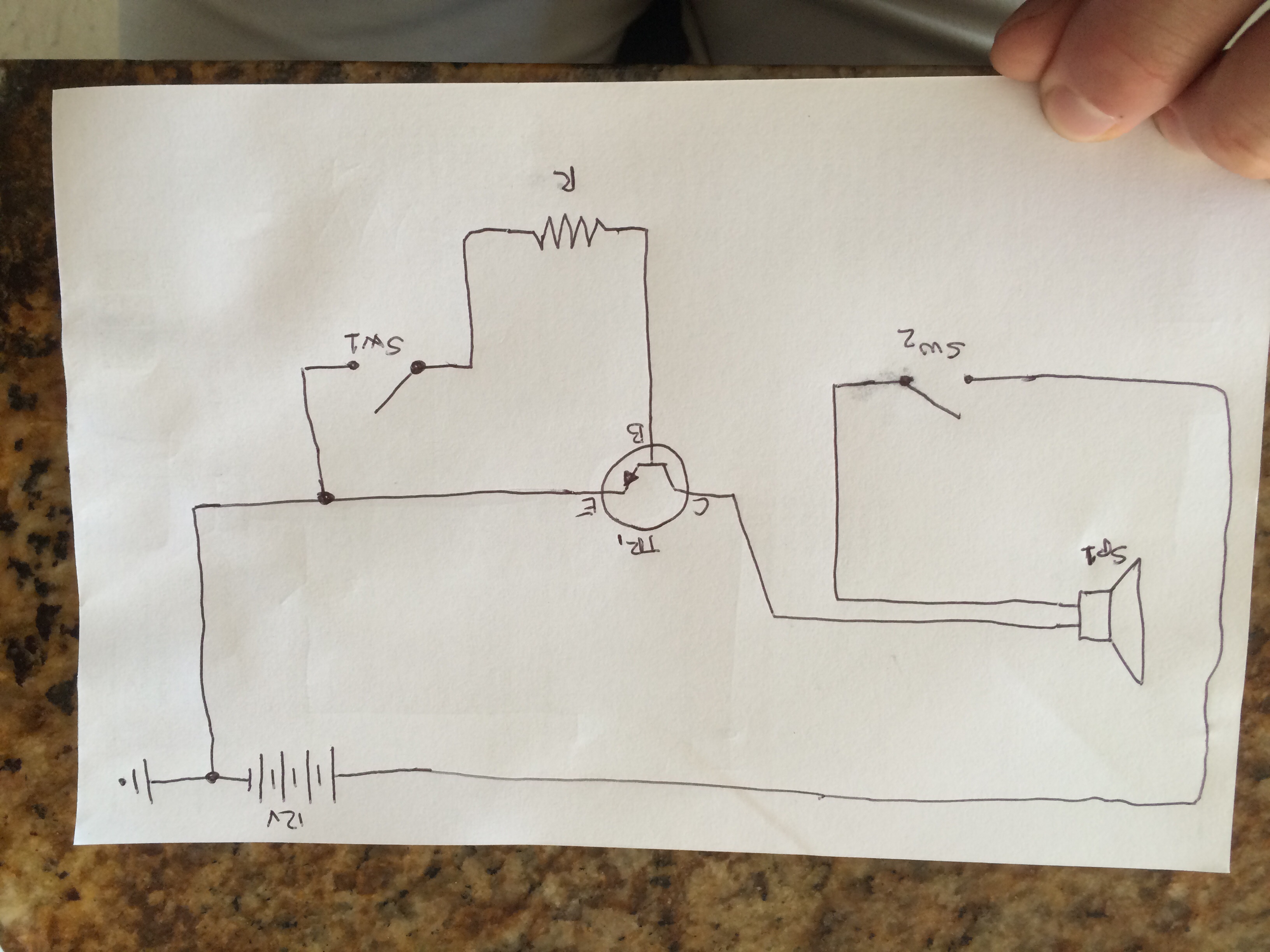

Postby tomaeugen » Tue Aug 19, 2014 3:20 pm
Is this what you ment?

Postby pebe » Wed Aug 20, 2014 3:06 pm
I have corrected your circuit. Use a 2N3704 for Tr1 and a 680ohm resistor for R. You have shown no oscillator to generate a tone, so you cannot use a loudspeaker. If you wanted, you could use the two-tone piezo siren shown as item number ST019 on this link, that has its own built-in two-tone oscillator:
http://www.bitsbox.co.uk/index.php?main ... th=302_309
Alternatively, you could use the 2½” 64ohm speaker shown on that page. But that would need a different circuit to include an oscillator (using an LM555). It would also need a series resistor to reduce the voltage applied to it. If you want to go that route, let me know.
