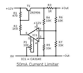

(Edit). I cannot see how you get nearly 12V from the op-amp output - the data sheet gives a maximum of only about Vs minus 2V (10V) - hence the need for the potential divider R1/R2 on the base of T1.
Re: output with short cirquit protection and current limiter
Postby pebe » Fri May 09, 2014 10:19 am
Here is a modified circuit with R3 in the positive output lead.
The dividers R4 to R7 are necessary because the 3140 inputs cannot be taken up to the positive rail. If you can find a suitable op-amp with rail-to-rail inputs and offset nulling capability, then you can get rid of the dividers and wire the inputs direct to R3.
If the op-amp also has a rail-to-rail output then you can get rid of R1.
Current-Limiter 2.GIF (3.66 KiB) Viewed 21746 times

Well I tested it but the output is always 0V because the opamp out is 11,5V and so
the transistor opens. Both inputs of opamp are nearly 0mV.
It needs a path from circuit input side to opamp inputs to make a voltage diffrence between both inputs and so a level change for swiching the transistor into on state.
Silvio.

Postby pebe » Sat May 10, 2014 8:42 am
Oops! I should have given it more thought. No output voltage - no nulling.
This revised circuit should do it, though I cannot understand why the nulling pot did not work before. Page 8 of the CA3140 Intersil data sheet from this site gives details of offset nulling and shows that the pot on its own is more than adequate - indeed, it suggests padding resistors may be required.
http://www.datasheetcatalog.com/
One reservation I have is that as the output voltage falls as T1 cuts off, the input voltage range will also fall and I am not sure that the input offset voltage will not change as the inputs go from about 8V down to zero. If it does, then it may be necessary to provide some hysteresis. I much prefer my first circuit where the situation does not arise.
Current-Limiter 3.GIF (3.87 KiB) Viewed 21667 times
