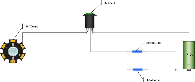

Anyway, I recently got into lightsaber making and wanted to include an illuminated pushbutton switch for my next one (I also make replica props and costumes as a hobby) I'm pretty sure this circuit is right, but a niggle keeps nagging, could someone have a look at the attached sketch and let me know if it would work ok?
I'm trying to figure out a way so it only lights up when the switch is on for the main LED far left.
Tried working out how to put the button on live, but the resistors end up in series and I'm sure it would effect the circuit in some way, but just not sure how (ideally i want the 1R8 1w by the battery end to help disperse the heat buildup, though it won't be running for long periods anyway, maybe 15mins tops at a time).
Thanks for looking :)

If the two long leads of the switch connect together when it is on, and the two short leads are to the LED indicator, with the anode of the LED to the 33ohm resistor, then yes, the circuit is OK.

[quote="pebe"]If the two long leads of the switch connect together when it is on, and the two short leads are to the LED indicator, with the anode of the LED to the 33ohm resistor, then yes, the circuit is OK.[/quote]
Thanks for confirming that for me pebe :)
