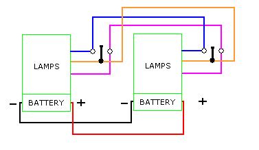

Postby RavenXCross » Sun Jul 28, 2013 8:56 pm
I want to run two of these...
http://www.tmart.com/Bicycle-Turn-Signa ... 12716.html
off of one control switch.
What do I do to raise the voltage?
I ask this, because I don't want to burn out the controller, due to the batteries being stored in the light modules.

It's not clear from the photos how the switching is done. Presumably left and right indicators can be selected as well as the red light turned on. Yet there only appears to be a 2core cable leading to the switch. Can you describe the switch action?

It won't be difficult. But will you first check that on each lamp no switch contacts are being made when the turn indicators are not used?

Postby pebe » Thu Aug 01, 2013 1:05 pm
One picture is worth a thousand words. Wire up the 5 points as shown in the drawing.
Either switch will then work both lamps. You can leave out one set of batteries if you like.
Bicycle lights.GIF (3.49 KiB) Viewed 16593 times
