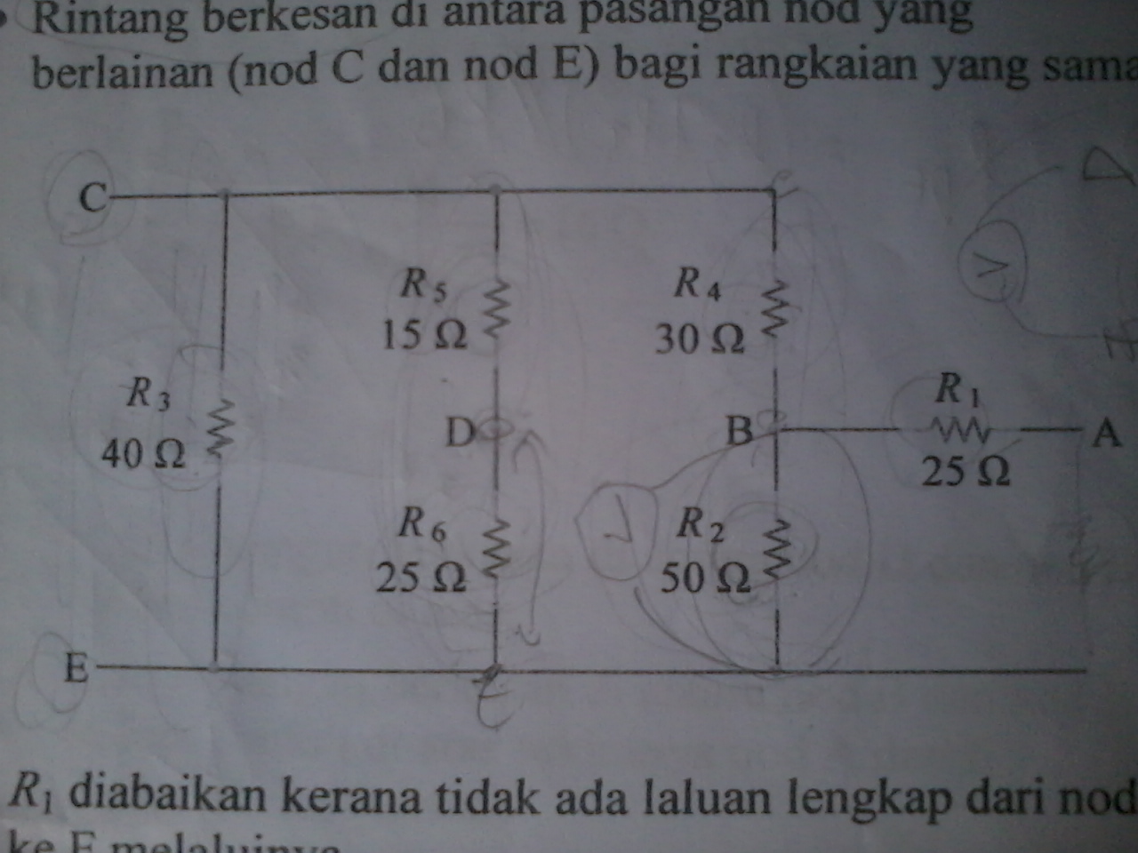

i have tried to find the effective resistance between node D and node E .. by making (R4+R5+R2)//R6 :D
but i think this is wrong .. do u guys have any other approach to solve this problem.. i wanna know how to find the effective resistance between node D and node E.. :wink:

Postby pebe » Fri Jul 05, 2013 5:34 pm
There is no attachment showing the circuit.

Postby pebe » Sat Jul 06, 2013 10:12 am
It's difficult to see your circuit because of the need to scan back and forth. It would have been better if you had used a .gif file instead of a .jpg file, and reduced its size. However,
Let Ra = R2 + R4
Let Rb = Ra and R3 in parallel
Let Rc = R5 + Rb
Effective resistance between D and E = R6 in parallel with Rc
