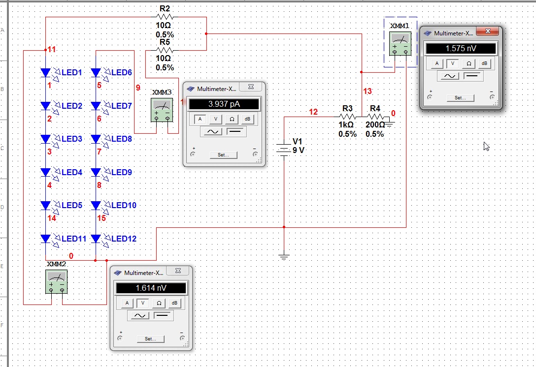

I wasn’t sure if series or parallel would be better for the array. Here is what I came up with so far. The current is too low I believe. Also, Im not sure how long the battery would last. Maybe a 6 LED version? Thoughts?
Thanks in advance,
Russ
I attached a screen shot. Please see below.
IR Light circuit

Postby Thomas W » Thu Oct 27, 2011 5:35 pm
Hi Russ,
What's the purpose of R3 and R4?
You would want a current of 140 mA in XMM3.
Thomas

Postby Mavruss » Thu Oct 27, 2011 7:23 pm
R3 and R4 is a voltage divider. I didnt want the full 9 volts hitting the LEDs.
Yes, I believe 140ma is the max on those LEDs.

Postby Thomas W » Fri Oct 28, 2011 7:59 am
There will only be 1.5 V across each LED. With 2 x 6 LED's in series the total voltage across the LED's is 6 * 1.5 = 9 V.
You should probably only put in 2 x 5, and let the rest of the voltage fall across R5 (and R2). 5 * 1.5 = 7.5 V, which leaves 9 - 7.5 = 1.5 V across R5 (and R2).
Try connecting net 13 directly to net 12 and see what happens.

Postby Thomas W » Sun Oct 30, 2011 9:32 am
That's good.
The resistor values can be calculated like this:
R5 = R2 (They're in parallel so the same voltage (VR2) will be applied to each one.
IR2 = ILEDx = IR5
R2 = VR2 / IR2 = (VBATT - (5 * VLEDx)) / ILEDx = (9 - (5 * 1.5))/0.140 = 10.71 ohm
Power:
PR2 = PR5
PR2 = IR2^2 * R2 = ILEDx^2 * R2 = 0.140^2 * 10.71 = 0.2099 ~ 210 mW (1/4 watt resistor will do).
The LED's will load the battery with 2 * 140 mA = 280 mA.
I have a 9V rechargeable NMH battery that holds 175 mAh.
If the voltage is the same it will last 175 / 280 = 0.625 hours = 0.625 * 60 min. = 38 minutes
but check the datasheet for the battery if you want exact numbers.
Did you consider the safety of your eyes regarding IR light?... (I have no idea how much it will take to do any damage...)

Postby Thomas W » Sat Nov 05, 2011 12:01 pm
If you put in an on/off switch for the R5 branch you can switch off 5 of the LED's and you'll the double battery life.
In order to calculate a solution you'll need to decide how much light you want measured in candela [cd] and then go backwards and find the best LED's / current / battery combination. This can be difficult so a field test with the mentioned switch in the circuit will give you something to work with in order to move forward with the project.

Postby Thomas W » Thu Dec 01, 2011 10:17 am
You should limit the loading of the AC/DC adapter by using only one LED branch (140 mA), and redo the calculations with 12 V instead of 9 V.
Did you test it with 5 or 10 LED's?
Do you have access to a physical ampere meter so that you can check the actual LED current?
(Here's the schematic for unregistered forum readers:)
[img]http://diagramtips.com/images/2011/ir_light2.png[/img]
