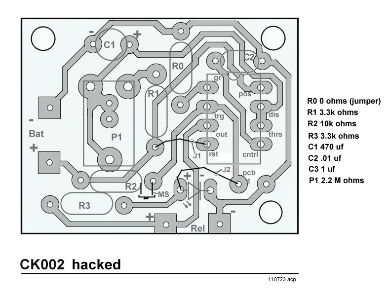

Postby [email protected] » Sat Jul 23, 2011 9:24 pm
Good afternoon Pebe,
Well its Saturday and I get to work on my circuits.
In order to understand the Cana Kit CK002 I drew a picture
of a combination of the traces and the components
http://www.allenpitts.com/electronics/5 ... line_b.jpg
Then using your excellent suggestions I changed the
circuit
http://www.allenpitts.com/electronics/5 ... hacked.jpg
The main idea is I am using a PIR (passive infrared detector) to activate an LED display.
http://www.goldmine-elec.com/pdf/G4567.pdf
The PIR signal ony lasts two seconds. So the G4567 should trigger a tmer circuit, the CK002, to operate a relay that controls the power source to the LED display.
The problem is CK002 only stays on as long as it gets power. I think the problem is that the CK002 system needs power but that power should be
separate from the signal to pin two (trigger) of the timer. That is, the CK002 gets power all the time but the power to the trigger pin would only
be applied by a moomentary switch in test and by the G4567 in the final system.
So I changed the circuit
First I added J1 which connects pin 4 of the 555 to the 9 volt power source according to the suggestion to connect the reset poin of the 555 to the power source.
Then I added J2 so the LED would work.
I reasoned that when R2 was disconnected the connection to the trigger would be lost and and a momentary switch between R2 and the trace to the trigger pin would act as a trigger. So I could leave the power connected to the CK001 system but the trigger which fires the timer and the relay would only be activated by pushing the momentart switch.
But it disn't work as expected. The system stills stays on as long as the
battery contacts are connected. Also I must have caused a short to the LED because seems to have fried.
So I tried several different configurations with no luck. But in the process
of trying different wirings, with J2 connected to the positive end of the LED and the other end of J2 disconnected, I accidently touched the non LED end of J2 to connection point marked pcb1 that is connected to the trace that leads to pin 2, the trigger of the 555. The circuit acted as required for several cycles and I was thinking about connecting a momentary switch
or the signal from the PIR between pcb1 and the anode of the LED.
But then circuit quit working and I am back to square one.
Any ideas what I am doing wrong?
I have not tried to connect the diodes across the output because I got
involced in the trigger problem before I got to the diodes.
Thanks.
Allen in Dallas
[email protected]
Joined: Mon Jul 18, 2011 1:13 pm
Postby pebe » Sun Jul 24, 2011 11:36 am
Hi Allen,
When I said "In the CK circuit C3 must be removed and the connections from your relay contacts wired in its place", I meant the contacts of the 5V relay operated by the PIR detector in your first posting. They trigger the timer.
Here is how it should be wired. Connect up the diode as shown if you are going to drive a relay with the timer.
555 board.GIF (57.52 KiB) Viewed 25695 times
