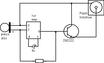

My second attempt added an 741 op amp to try to boost the piezo signal, but the same problem remains..

2. The outout of the 741 (pin6) needs to be normally at less than 0.6V so it does not trigger the 2N2222. As pin2 will follow pin6, it also needs to be <0.6V. But the 741 needs pins2 & 3 to be at least +1.5V relative to pin4 - so the circuit cannot work.
