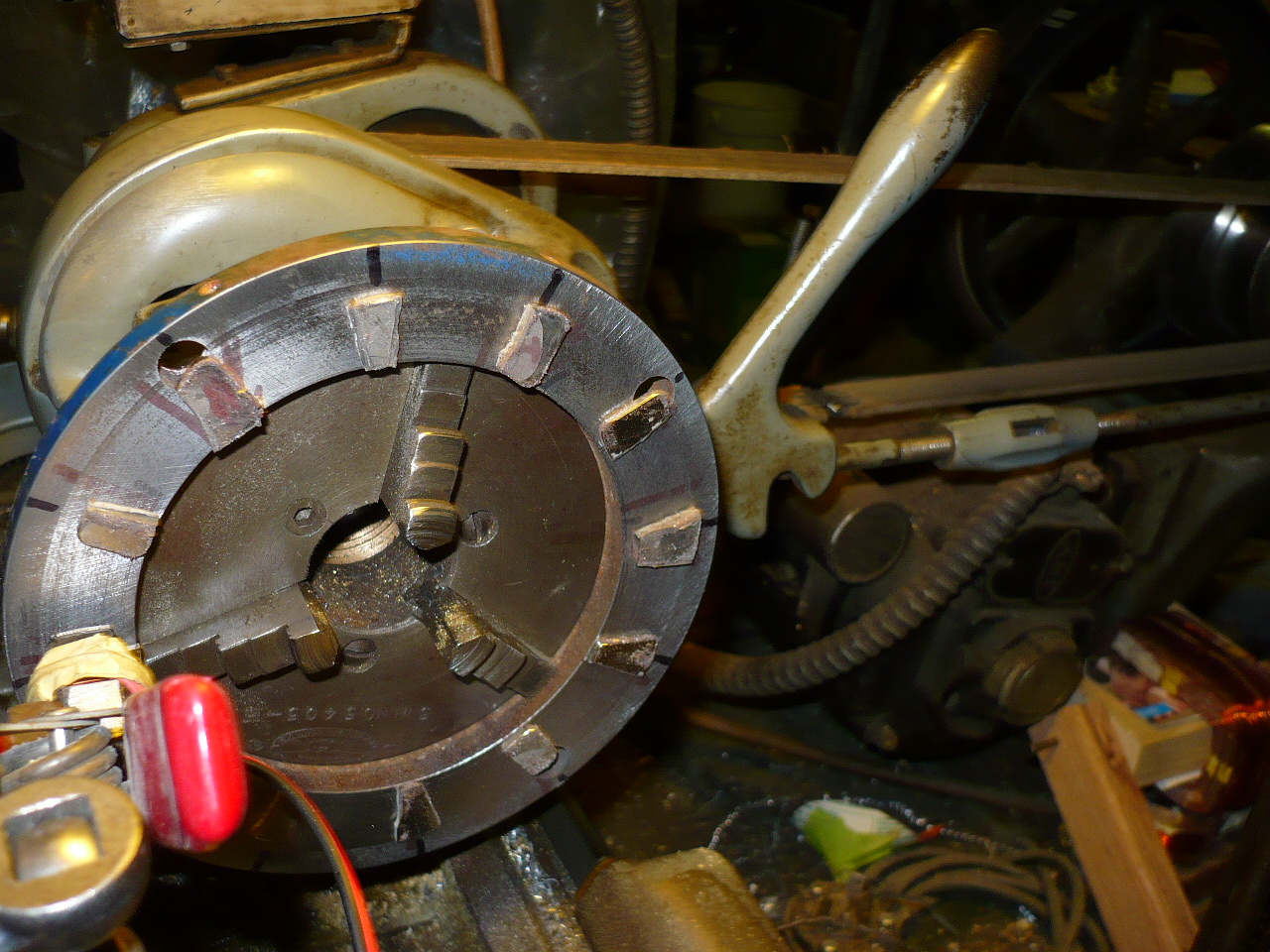

For my prototype, I mounted the 12 magnets on a 6 in diameter cast iron ring, and set that up on my lathe which I know runs at 325 RPM. The DC output is about 0.25V for that speed. The DC output seems to be fairly linear with speed.

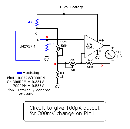

Hi miro,
Here is a circuit that will do what you want. A CA3140 op-amp converts the output voltage at pin4 of your 2917, to current through a 100µA meter. If you want to use a 50µA meter, then change VR2 to 10K. You can change the op-amp but it must be one with FET inputs capable of running with inputs as low as 0.2V. Bipolar types such as the 741 won’t do.
Pin4 gives a voltage of 0.25V for a speed of 325rpm, so it follows that pin4 changes from zero at the rate of 0.077V per 100rpm. So you will get 0.231V at 300rpm and 0.538V at 700rpm. That will put 500rpm at mid scale. If you want a different RPM span, then change these two voltages as appropriate when setting up.
The voltage at point ‘A’ is provided from the stabilized 7.56V available from pin6 and is the reference voltage for comparison with pin4. Set it up like this:
1. Disconnect the meter. Set VR1 and VR2 to max resistance.
2. Switch on, and adjust VR1 to give 0.231V at ‘B’.
3. Now simulate the signals at pin4 like this:
4. Temporarily connect a 100K pot, P1, (wired as a variable R) in series with a 270K resistor between pin4 and pin6.
5. Set P1 to give 0.231V (= 300rpm) at ‘A’.
6. Connect the meter. If necessary, re-adjust VR1 to give zero current in the meter.
7. Set P1 to give 0.538V (= 700rpm) at ‘A’.
8. Adjust VR1 to swing the needle to full scale.
9. Set P1 to give 0.385V (= 500rpm) at ‘A’. Meter should read mid-scale.
10. Remove the temporary resistance between pin4 and pin6.
The meter will be reading backwards (less than zero) when the motor is running at less than 300rpm. If you don’t want that, insert a 1N4148 diode at ‘X’ with anode to meter after setup.
Please note that R2 is there to limit current to prevent accidental needle damage.
If there’s something I haven’t covered then please shout.
(Edit 16.01.13 - 2917M IC number corrected)

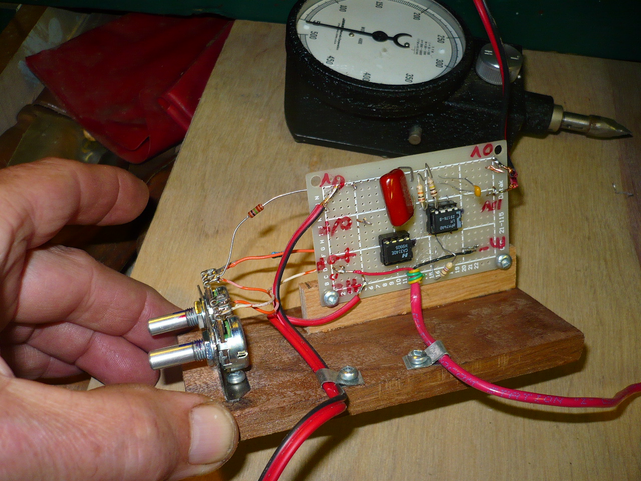

Well, I finally did get to the task of adding the expanded range circuit to the tachometer.
I can report that even though I am not an experienced circuit board guy, I did manage to add the components to the existing circuit board, and I did manage to get it operating.
Adjusting it took a bit of tweaking, but that's part of the learning process.
I set it up so that the zero on the meter is 375 RPM and the full scale is 600 RPM. That' s a bit different from what I had in mind originally, but I think it will be better for the sawmill operators.

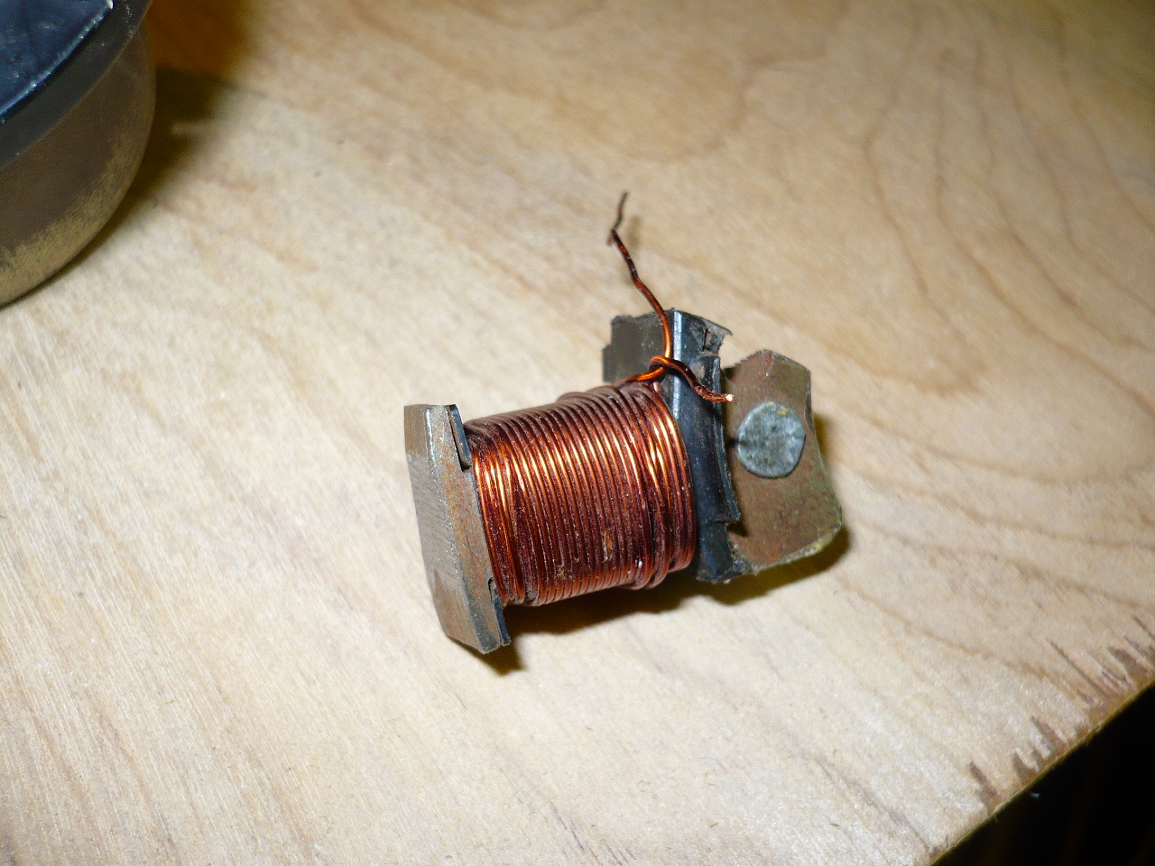

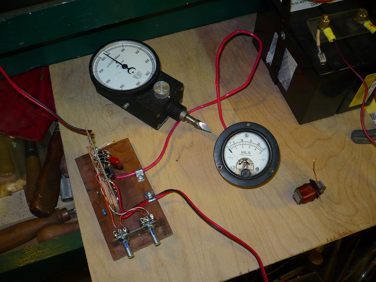

Postby miro » Sat Apr 05, 2014 1:54 am
My attempt at pictures . . . miro
[attachment=3]
A view of the circuit board, meter and mechanical tachometer I used to calibrate the electronic tach
This is the cast iron ring with the 12 magnets harvested from hard drives

This is the pickup coil I used on the rotating magnets to get the input signal
Here's my circuit board - amateur attempt to be sure - but it works. I'll make a nice case for it later.
