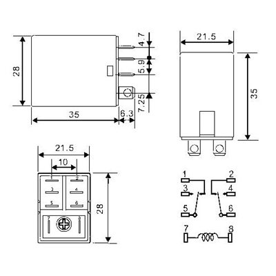

Here is a pic of the relay I have..Thanks in advance!

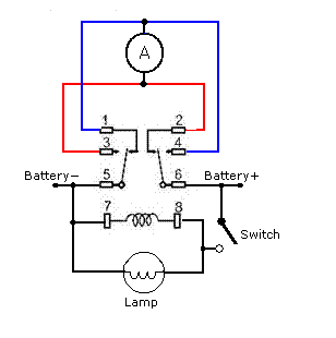

Postby pebe » Wed Aug 14, 2013 5:32 pm
Here you go.
A is the actuator. The two switches shown are the extend-retract limit switches. V- and V+ are the power supply.

Postby pebe » Wed Aug 14, 2013 11:33 pm
Here is the corrected diagram. You said the actuator stops where it should with the diagram I first supplied, so it would appear that the limit switches are built-in - ie. there only two wires available. If so, wire it up like this. If the limit switches are separate, fit them where shown at X. If it then doesn’t work, transpose the switches.

It seems like the coil is not pulling the relay in. Could you post a diagram of how the coil, lamp and operating switch are wired up?
Re: Linear Actuator to Reverse when power is off
Postby Forcedfed » Sat Aug 17, 2013 1:56 am
OK.. I'll send some pics when I get home.. When you say coil, are you talking about pins 7 and 8?.. I don't have those hooked to anything.

Postby pebe » Sat Aug 17, 2013 2:07 am
That's your problem. You need those pins wired across the lamp so that when you switch on the lamp the coil is energized and the actuator extends. When the lamp is turned off the coil de-energizes and the other set of contacts make and reverse the actuator.

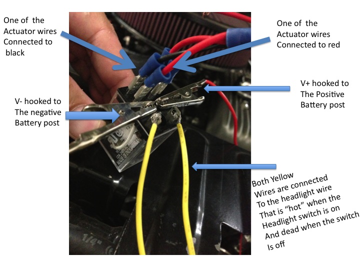

Made sense but it didn't work! I took pics and started labeling it to post, but I had to leave.. I'll post it it the AM, sorry its been such a PITA!
The V+ and V- are clipped right to the battery posts (+ and -), pins 7 and 8 are now tied together and were hooked to the headlight wire that gets hot when I pull the headlight switch on which I figure would power up the coil, the actuator is wired like the diagram. I can make the actuator move by switching the 2 wires back and forth on the battery itself.. Pics will be up tomorrow..

Postby Forcedfed » Sat Aug 17, 2013 7:33 am
Here it is..

Postby pebe » Sat Aug 17, 2013 7:59 am
Here is how to wire it up.
Postby Forcedfed » Sat Aug 17, 2013 5:12 pm
Yes! That's better... Works now!
