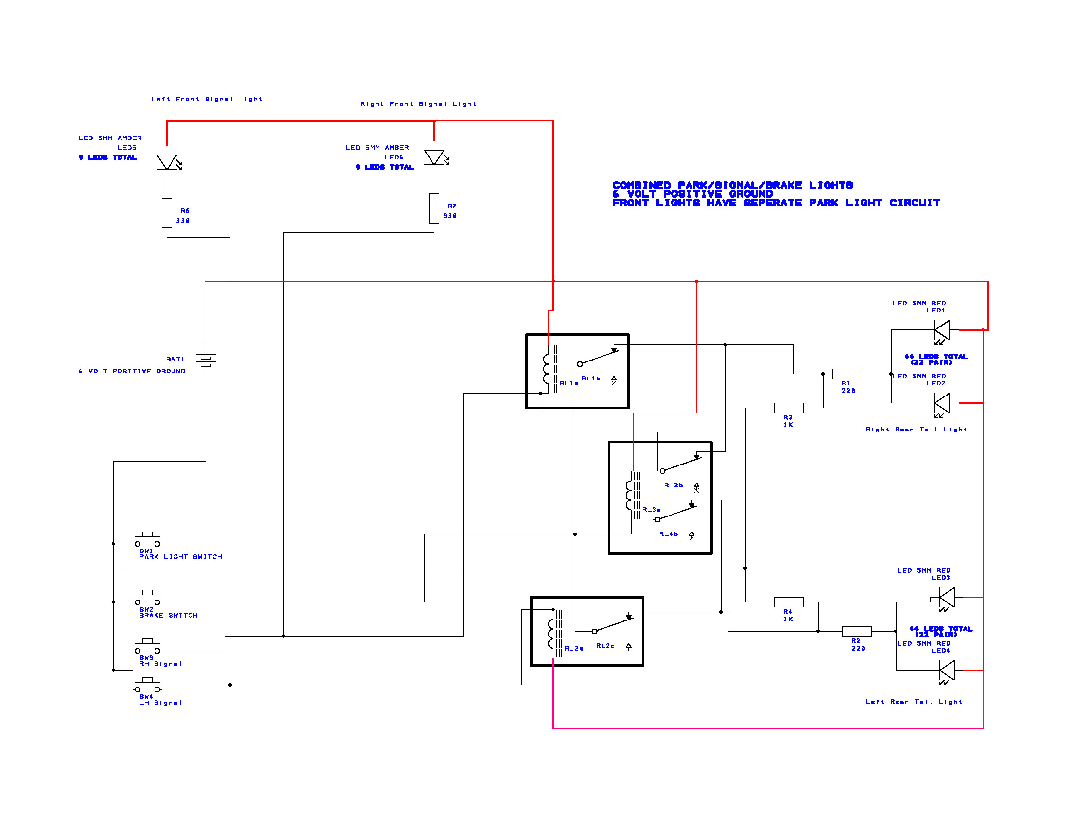

Hello all,
I am just a dabbler in these things electronic but hope one of you might help me.
I am restoring a antique pickup which has a 6 volt [u]positive[/u] ground electrical system.
I've machined new light inserts which will receive leds instead of the old dull 6 volt bulbs.
I would like to use one set of leds in the rear housings and fire them differently whether using the running lights, brakes or signals.
I've attached a proposed circuit and I hope someone would comment if this looks ok or I need to make some changes.
For instance, I am concerned about how powering the coils of the relays in the back lights might affect the front signals.
Thank you very much in advance.
Brad
6 volt signal light.jpg (304.55 KiB) Viewed 10012 times

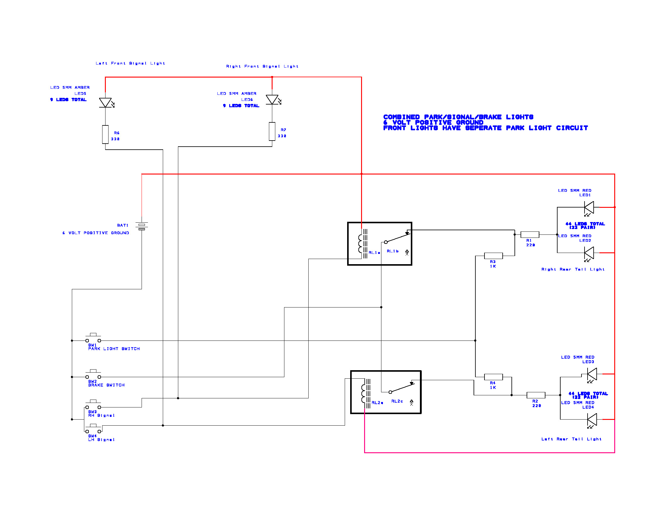

Oops, I have changed my proposal as I hadn't supplied a circuit to the signal lights when the brake was not on.
Thanks for looking,
Brad
6 volt signal light circuit revised.jpg (321.13 KiB) Viewed 9999 times

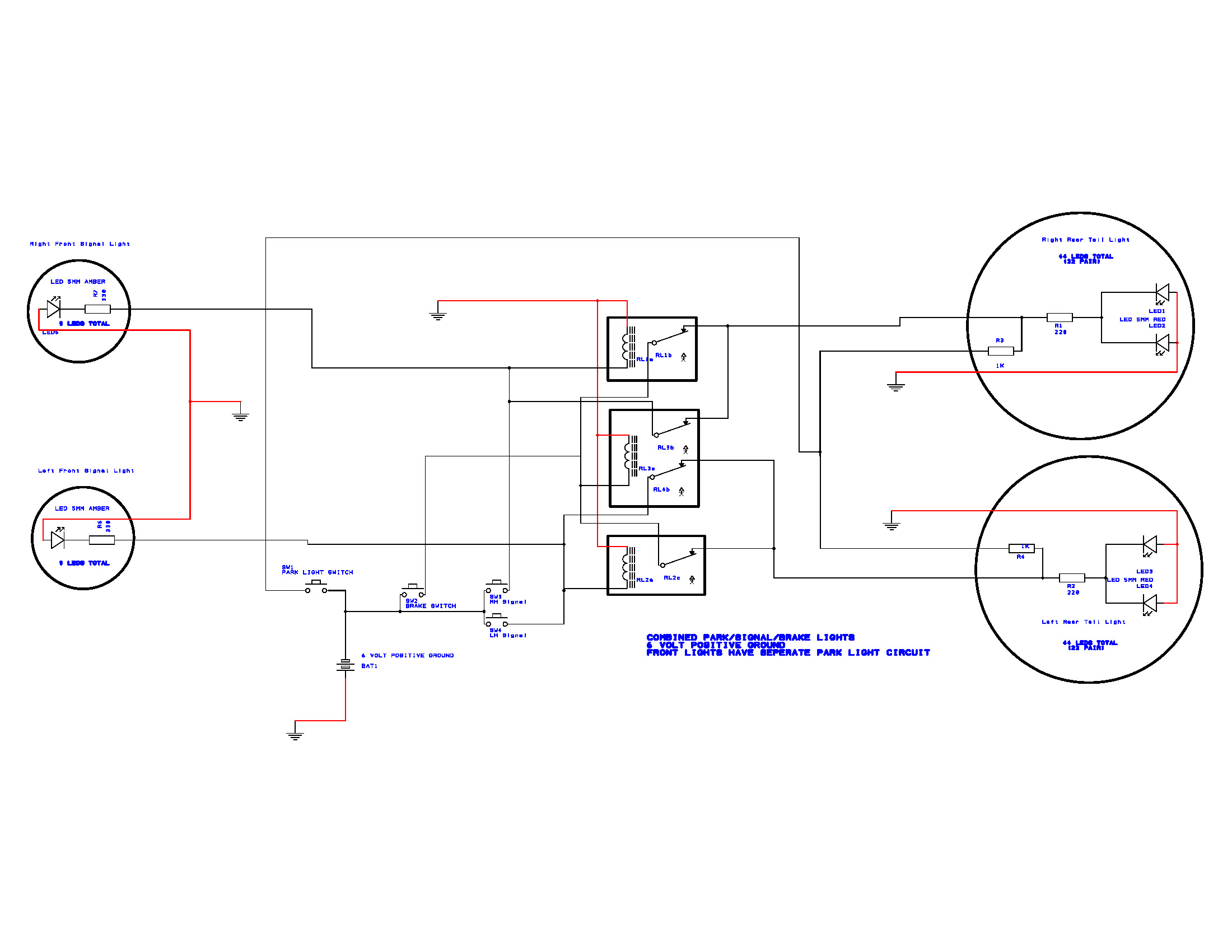

I have changed the schematic once more just to make it a little clearer to me.
I'm pretty sure I'll need some diodes in there somewhere but it's confusing being positive ground.
With all the switching, I would think maybe some snubbers?
Brad
6 volt signal light circuit revised 2.jpg (296.2 KiB) Viewed 9990 times

Brad, it looks as though the park light switch is the only way that the tail lights are lit unless either the brakes are applied or a turn signal is initiated.
Is that correct?
Aren't the tail lights supposed to be on when normal lighting, i.e. headlights, on?
