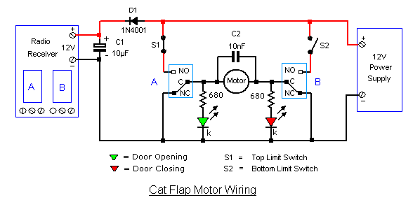

Hi Garry,
As the assembly once completed will be permanent, you might try a spot of glue on the shaft before fitting the pulley.
Here is the wiring for the LEDs. They just light up when the motor is running, as you wanted. The 'k' on the circuit indicates the cathode of the LED.
Cat Door.GIF (6.75 KiB) Viewed 21576 times

Pebe, I’ll give the glue a try, good idea. I will also implement the LEDs and resistors. Thanks again for all your help and kindness. As soon as I can get the LEDs and resistors I will install them and let you know. You great in my book. Thanks again for all your good help. Garry (GaS753)

Pebe, I finally have everything installed and working. The cats have had no trouble going through the door when it opens. The LEDs are a plus to the operation and are working fine. So I can not say enough about your wonderful help, without you this very helpful project would never have got off the ground or be in place and working. Thanks again for all your help and kindness. Hope your holidays are filled with joy. Garry (GaS753)
