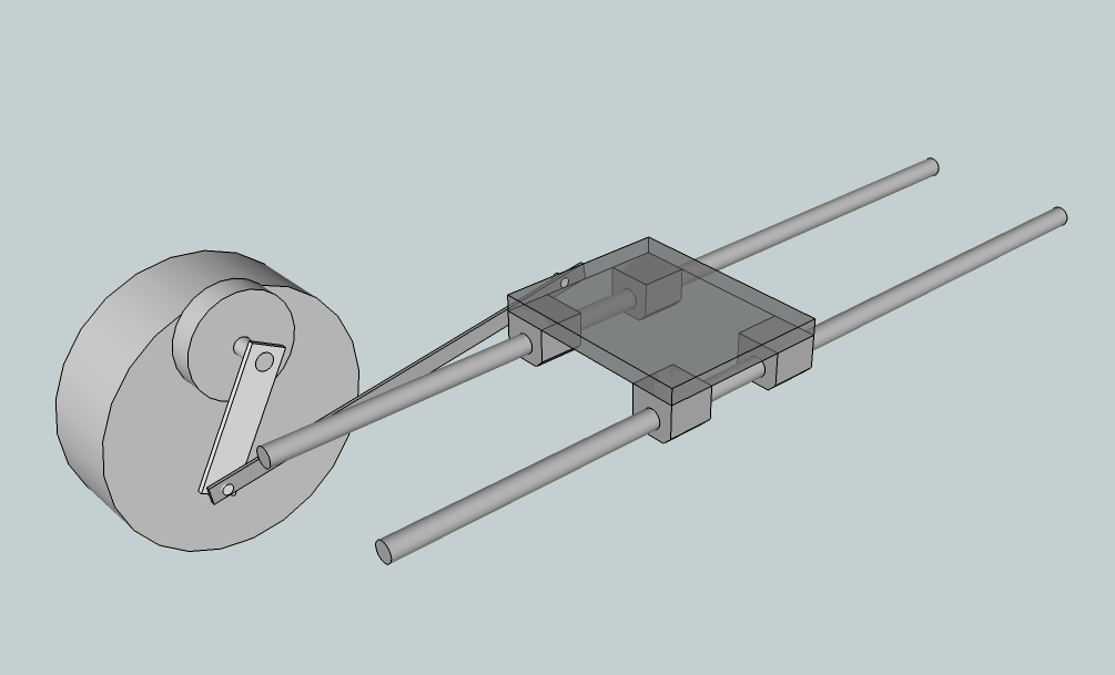

is it a fixed length linear movement, or does it need to be adjustable?
one idea is to change the way you are doing it a little, using some linear bearings (pretty cheap if you look around) on a axis.
I have attached a google sketchup drawing of what im talking about.
contact me with your email if you want me to send the sketup file.
I have made a couple of things using this method in the past for friends.
Good luck
