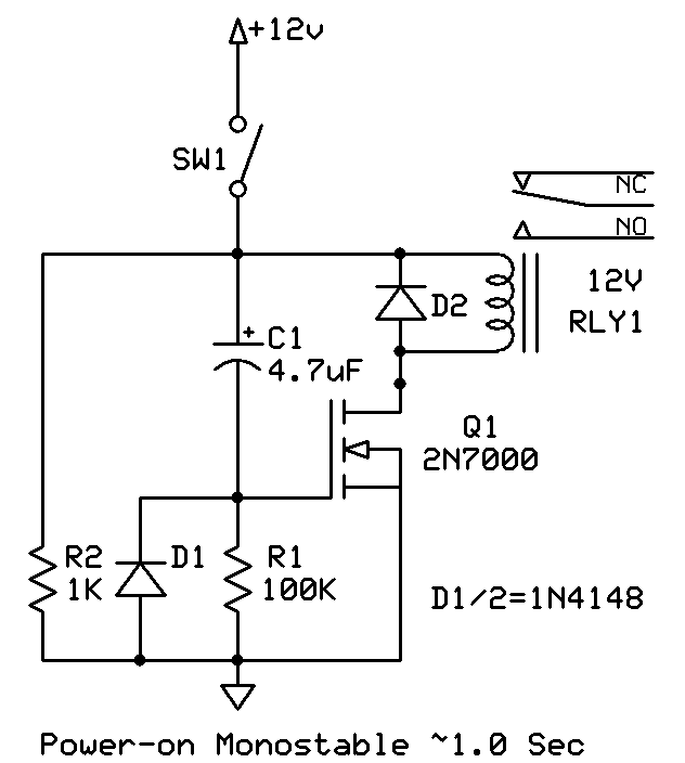

The 12v solenoid only needs a short pulse from a bell button.
The problem is if the bell button is held depressed and the 12v are continious to the
solenoid. Can someone help me to a simple circuit to only give a pulse, no matter how
long the bell button is held depressed ?

What you are looking for is a monostable multivibrator type circuit. Check out 555 monostables.
Or, the simple circuit attached. Just replace the relay with your solenoid. You didn't say how much current the solenoid draws. If over 500mA, you would need a higher power MOSFET than the 2N7000.
2N7000-Relay Monostable.gif (8.05 KiB) Viewed 10330 times

Thank you Ken,
Since i am in the shinola group could you help me with the type of capacitor so i can
build this circuit?
I was also wondering if there was a premade type of circuit that would be in series
with the switch, power source and solenoid to open up after a small amount of time,
so that continuous depression of the switch would cause no harm.
Thanks for your help,
Bert

Postby KMoffett » Tue Sep 30, 2014 7:44 pm
The capacitor is an electrolytic type. Any 4.7uF with a voltage rating of 16V or greater. Off hand, I don't know of a 2-wire inline monostable switch.
