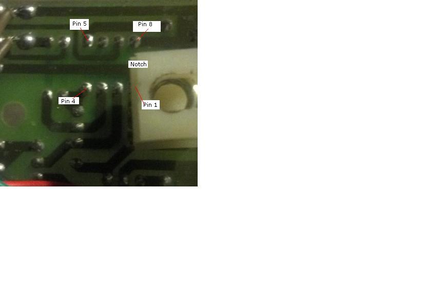

pebe is there any way you could number the posts on the picture of the bottom of the board so i know what is what when i go to do it. thanks that would be so helpful if you could. thanks

Postby pebe » Sat Jun 28, 2014 11:21 am
Yes, the resistor is 470 ohms.
My circuit showed the PIC with the pin numbers marked on it.
There is a simple rule for identifying pin numbers:- Look for the notch on the top of the IC at one end. Looking at the top, the pin to the left (anticlockwise) from the notch is always Pin1. The other pins are numbered successively from that one, counting in an anticlockwise direction. That rule holds true however many pins the IC has.
I have marked the pins on your photo of the underside.
PIC piins.JPG (22.76 KiB) Viewed 15123 times
