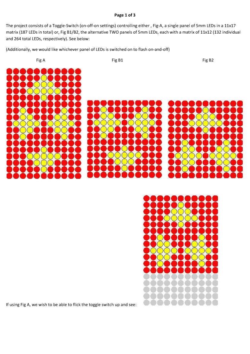

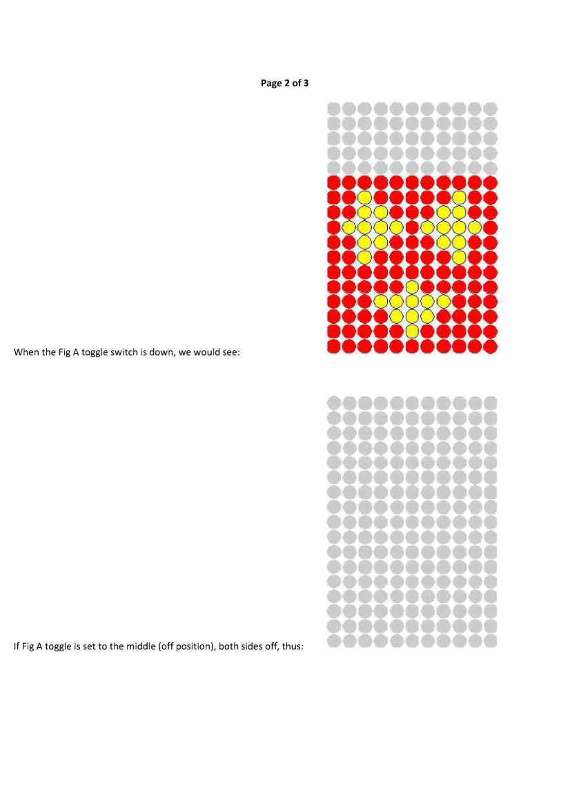

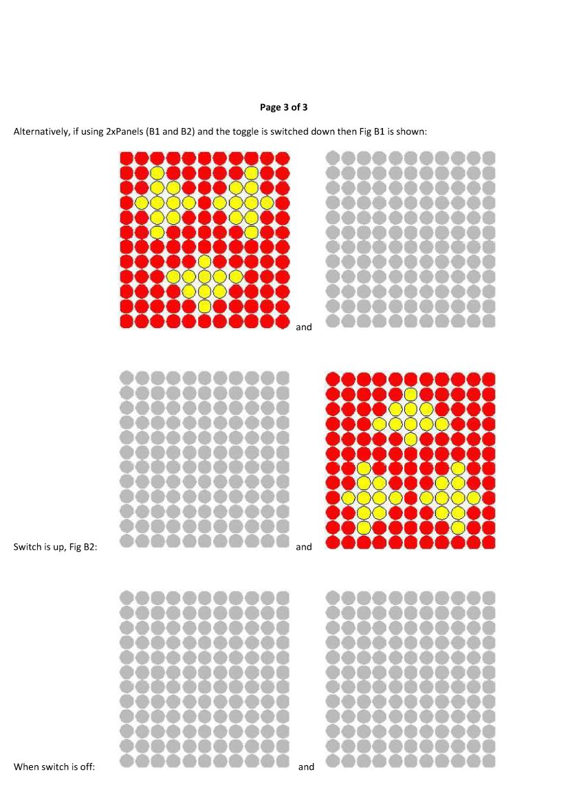

I want to produce an up/down, flashing, LED sign and have attached my own (non-schematic) diagrams of what I hope to achieve.
I have no idea whether this is a simple or a difficult project, I am so “green-behind-the-gills” and do not even understand the advantages or otherwise of running the proposed LED project in either Series or Parallel mode.
I would wish to power the project from either AS/DC adaptor or a 12 volt car battery and only for very short (on-demand) periods of time, similar to how often the button is pressed on a Pelican Crossing, say.
Is anyone able to offer any help and advice, please?
[attachment=2]

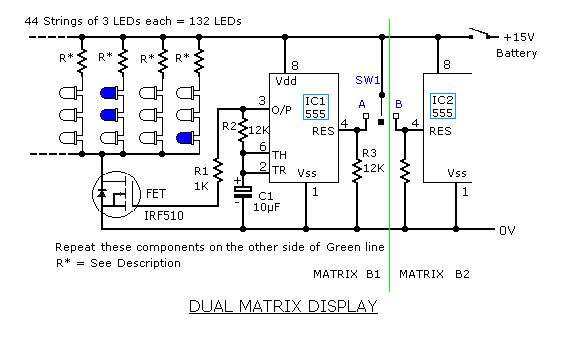

Here is the circuit. I suggest using two 11x12 matrices because if the 11x17 display were used, the 5 rows of LEDs that are common to each lit display would require 40 isolating diodes that would be neither practical nor economical.
The circuit to the LH side of the green line is for matrix A. All the components need to be duplicated for matrix B. IC1 and IC2 are both normally reset (off with outputs low). Sw1 then selects which matrix is to be lit by raising the voltage on the reset pin of the wanted one.
The 555 feeds its output to the FET that switches the LEDs. The FET is needed because a 555 can only switch 200mA but the LEDs will take almost 1A. The 555 switches the FET at a rate of 1sec on, 1sec off. That timing period is determined by the values of R2 and C1. Relays could have been used to switch the LEDs but in this application FETs are probably more reliable.
To be economical on battery current, the LEDs are grouped into strings, with the surplus voltage being dropped by R* to stabilize the current. As the blue and white both have the same voltage drop and current, they can be mixed in the strings. I have shown 3 LEDs per string with a 15V supply, because if a 12V supply were used it would be necessary to have only 2 per string, resulting in a battery current increase of 50%.
It would be advisable to test and sort each LED for forward voltage so that R* for 20mA can be calculated for each string, ranging from R* = 220Ω for 3.2V LEDs to R* = 150Ω for 3.8V
To give a good display that doesn’t dim as the battery discharges, then the supply should be stabilized. The easiest way to get 15V from the battery is to use a boost adapter like these. They can be set for a steady 15V, whatever the state of the battery.
http://www.ebay.co.uk/itm/LM2577-DC-DC- ... 53fb047d31
http://www.ebay.co.uk/itm/DC-DC-Convert ... 565bccac29
For mains use you could use any suitable power source to drive the converter.
I hope that is what you wanted.

Thanks for devoting your time and experience on this for me, pebe (I just wish I knew visualise the physical layout of your schematic, as I don’t currently know how to read a schematic......I better get learning, fast, I guess!!). :?
Two matrixes as opposed to one is no problem as the total number of LEDs employed are only increased by one row, in this instance, so your advice certainly does seem to make good sense to me. :)
A couple of questions, or so, if I may:
1) What is a “FET” and where can I purchase them?
2) What effect, if any, on additional LEDs would the failure of any one LED have?
3) One matrix of 11x12=132 /3=44 Resistors. Does each individual Resistor have to be directly linked to a string of 3xLEDs or can the Resistors be placed in-parallel to each other on the control board and the whole row of Resistors then linked to a single point of the light-matrix (if that makes sense)?
All the best.
Jib T
