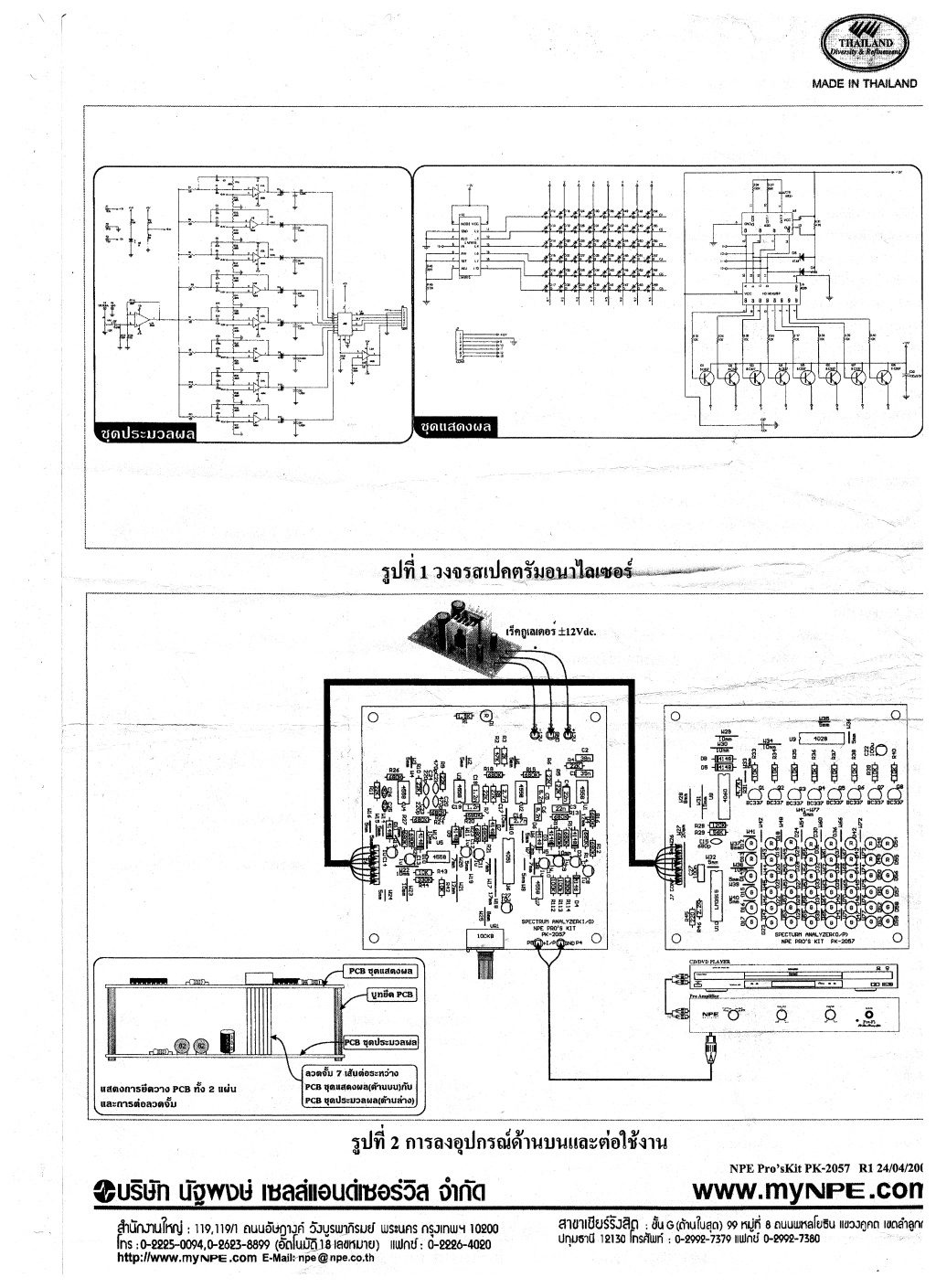

I have attached the schematic and parts list, any help would be greatly appreciated.
I am sure I need more wattage to drive the larger LEDs because they are so dim and they are on 3' leads...
I think what might actually be driving the LEDs is the CD4028BF. That seems to have plenty of power, but I am not 100% sure that is the role of that IC. It looks like the lm3915 is switching the negative on and off and the cd4028BF is providing the + voltage. There is a 10k resistor between each of the pins and a bc337 transistor:

Your circuits are too small to read, but you will never drive LEDs at 100mA from a LM3915. The max current you can program it for is 30mA.

Postby sandiegoman » Mon Sep 16, 2013 11:21 pm
Yeah, I figured that out now. I guess I will need transistors to provided a better sink. Thanks for your feedback.
