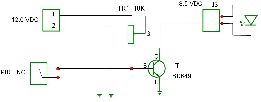

Postby tangolpe » Sun Dec 11, 2011 2:46 am
Hi Thomas
I measured the output voltage at the LED's and it is 8.5 v after the trimpot set to 1.5 K
The trimpot is a 10K[attachment=0]
modified
Circuit 2.JPG (21.98 KiB) Viewed 29907 times
tangolpe
Posts: 10
Joined: Sun Dec 04, 2011 7:25 am
Re: How to reverse a SCR
Postby tangolpe » Sun Dec 11, 2011 3:25 am
Hi Thomas,
Here are the goods news; the circuit is working perfectly. After experimenting with few capacitors, I added a 4000mF electrolitic cap at the LED's terminals so they fade slowly when the power goes off.
Thanks you and the forum administrator for this oportunity to receive help in this little project.

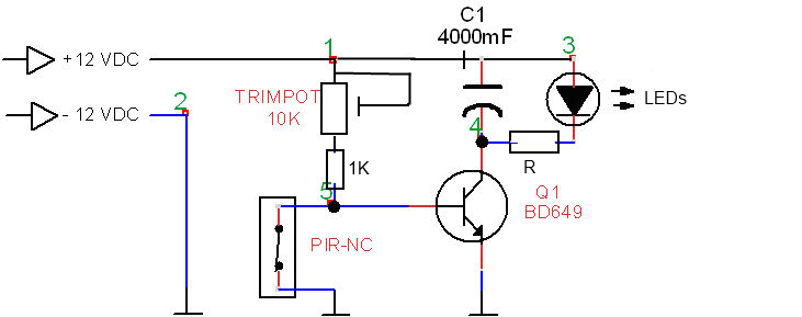

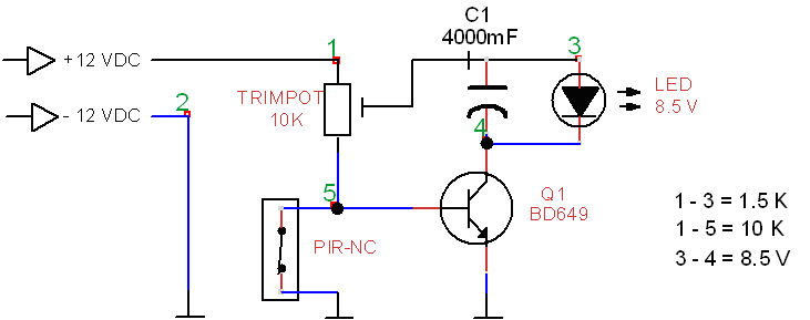

Postby tangolpe » Tue Dec 13, 2011 12:54 pm
Hi Thomas,
yes it is me........again
I forgot to mention that after i connected the cap, the LED's are turning on in three seconds, meaning the full 8.5 V.
The cap discharge so slowly that it takes one minute to disappear any light
I do understand the discharging concept of the cap but do not undesratnd why in the way up is not instant
with capacitor and trim
tangolpe
Posts: 10
Postby admin » Tue Dec 13, 2011 2:50 pm
There are some mistakes in the circuit. Do the circuit as attached and it should light up immediately now. I'm assuming that your LED is ok with 12V across it. Otherwise you may need to add a resistor of small value R (say 10ohm) in the circuit as shown. If the LED arrangement can take 12V, then R is not needed and can be replaced with a short.
regards,
Admin.
