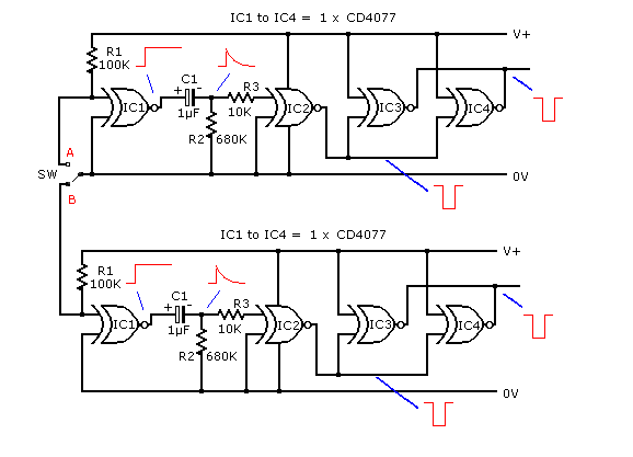

The circuit works GREAT for the recording/playback circuit board I'm using, but I've been requested to build a second one for somebody, and I dont have access to that type of board again. I'm going to need to use two separate "original circuit" boards (one for the 'up' message, one for the 'down' message) so my new request is as follows:
1) I'd like to use the spare 4077's i picked up to simplify getting the negative pulse.
2) I need a pulse from the output to activate only once per on/off cycle.
To explain, the current circuit you graciously came up with for me triggers on both the up and down switch action. I need to get a new circuit to the point that Gate 1 triggers on the up position so Output 1 signals the first board, and Gate 2 triggers of the 'down' action, sending the signal to the 2nd board. If it could still use the SPDT switch, great. but I could go back to the SPST if needed, I'd just use two.
Hmm, just had thought,... is this the type of thing a J-K flipflop is good for?
Whatever works best and easiest to build works for me. Thank you for any help you can give me again.

Postby pebe » Sun Nov 13, 2011 4:54 pm
Hi David,
Here is the circuit for you. It uses one of your existing 4077 ICs for each board. Although I have not shown it, both boards must share a common power supply. Here’s how it works.
For a 4077 gate, if its inputs are both low or are both high, the output will be high. If the inputs are different, its output will be low.
On the top board, with the switch at (B) the inputs will be different and the output of IC1 will be low. C1 is discharged so both inputs of IC2 will be low and its output will be high. The two remaining gates operate as non-inverting buffers so the final output is high.
When the switch is moved to contact (A), IC1 will change state, taking C1 high. The output of IC4 will pulse low until C1 has charged via R2 and taken R3 low.
When the switch is moved to contact (A) again IC1 will change state, but IC2 will stay the same because R3 is already low.
Moving the switch to (B) will give a negative pulse at the output of the bottom board, in the same way.
I hope it’s what you want.
XOR Mono.GIF (7.37 KiB) Viewed 33600 times

Postby JMACgyver » Fri Nov 18, 2011 1:13 am
Fabulous! Thank you pebe! The circuit works great. And only draws 50uA when idle. Now all that remains is to finish up the hardware portion of the gift in time for Christmas. (No small feat for me..I'm a perfectionist; last time i tried a gift like this, it took me past two of their Christmases and three of their birthdays to complete.)
Thank you so much for your help; couldn't have done it without you.
