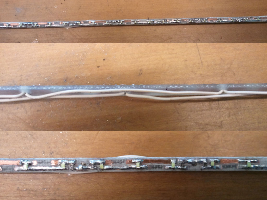

Postby gaskell » Fri Jun 24, 2011 10:02 pm
I am hoping that the single strip of 30 will light the screen as due to wire thickness I can only fit one strip.
Heres a cple pics of the finished strip. I resized them down and put them all together into 1 pic.
Next I'll put this into the screen and see what it looks like.
