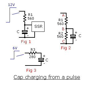

OK. I'll do you a circuit.

OK. I’ll deal with the source resistance first. The attached file shows in Fig 1 how the input to the SSR is wired, with the 12V pulse being fed through R1.
Fig 2 shows the equivalent circuit, with the 560ohms input resistance of the SSR replaced by R2. Note that as the resistors are of equal value, the steady state after the cap has charged will be 6V at point ‘B’. Not all the current through R1 is charging the cap, because some of it is going through R2. So we need to simplify the circuit in order to know the current flowing into the cap and charging it.
If we look back at the pulse source from point ‘B’, there are two resistors connected there; R1 connects from the 12v pulse whose output resistance will be very low, so if we ignore the DC voltage for the moment, R1 is effectively connected to ground. Point ‘B’ is also connected to ground via R2, so R1 and R2 are effectively in parallel to provide the source resistance that charges C.
Thevenin’s theorem states, loosely, that in those circumstances “….the two resistors can be replaced by a single resistor equivalent to R1 and R2 in parallel, and feeding the cap from the open circuit voltage at point’B’…”
The open circuit voltage at point ‘B’ is 6V, so Fig 3 shows the equivalent circuit with point ‘B’ being fed from 6V through R3, which is 280 ohms. That is the circuit we can use for the CR time constant calculation.
To answer your last two questions:
If the input resistance of the SSR is not 560, the simplest way is to change R1 so it is the same as the actual SSR value. But 560ohms will be OK provided the steady state voltage at 'B' exceeds the SSR input threshold of 3V.
The cap can be any voltage over 6V
More to follow soon, about the time constant.....
Cap Charging 1.GIF (3.11 KiB) Viewed 11800 times

That's so nice of you mate. I have downloaded the Yenka circuit simulator and can play around with different resistor and capacitor values. I read somewhere that using a transistor will eliminate the gradual increase in the voltage at the input and will only trigger when the desired voltage is achieved. Is there any benefit of using transistor for this application?

Just to update that I put together the RC circuit and it has solved my problem. Pebe thanks for your help mate :)
