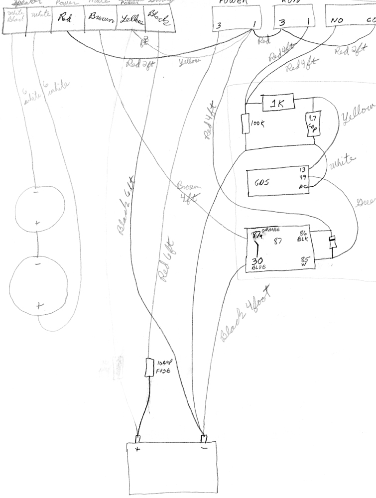

Just thought I would post my very porfessional :cry: wiring diagram of the organ project. Any suggestions as to how to fix it so the circuit could get energized quicker would be appreciated.

The top and bottom of you sketch are cut off. What is GOS, on the right side?

I uploaded a new picture. GOS is just the brand of transistor. I am using 16 gauge wire through out the whole thing. Could I go down to 18 gauge wire?

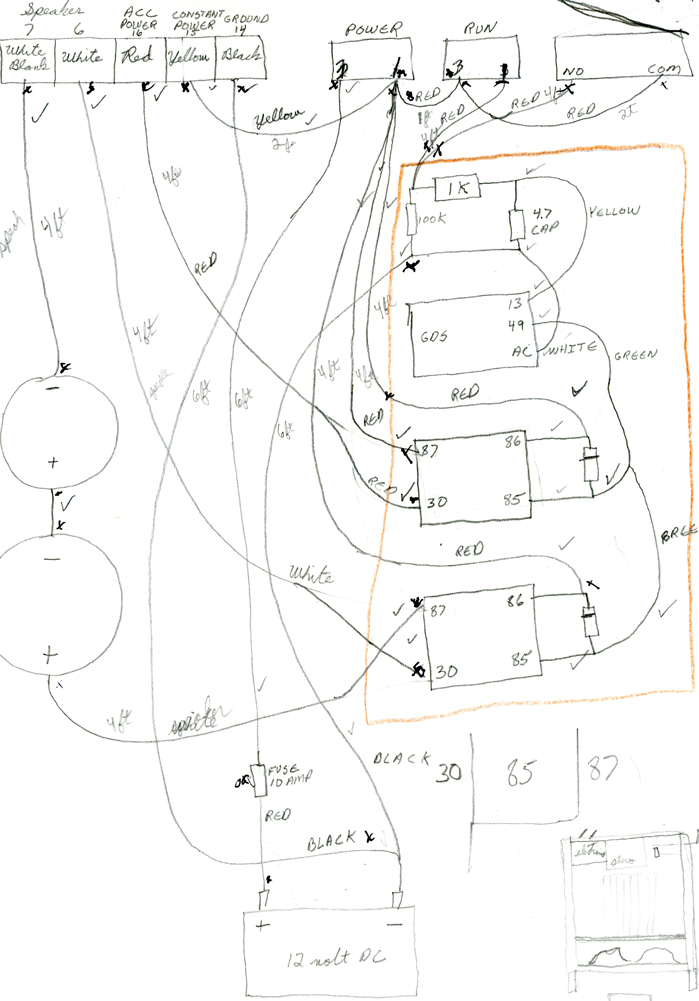

I came across another way to make this thing work. I have attached another poorfessional wiring diagram.

Any comments and suggestions would be appreciated.

As for being able to stop the music when cranking, the best method would be to pause the CD rather than mute it. Reason being, is that the CD will continue on regardless, therefore when cranking it up again would make it sound as if it skipped some of the music. If you're satisfied with that arrangement, then muting the player would be the way to go.
If you'd rather pause the CD, then you would need to make sure there is a pause button on your player. If so, then you would need to open up the facia of the player, locate the tactile switch for the pause button, analyze the way it works by studying the switch's tracks to see if they go to ground when switched. You'll find that 9 times out of 10, it will get grounded. You only need to attach one wire to the high side of the switch and that will then work as a pseudo mute.
As for the 6 second pause when re-cranking the lever before the music comes on, the picture below maybe the better way to go.

The main problem in using a switch to get the music going, as you've stated already, is the fact that you may stop the crank right on the point of it being switched. I thought you might be able to utilize a hall effect sensor arrangement using magnets, but the same may occur with that also. Whereby the magnet may stop and face the sensor. Same would happen with using an opto sensor arrangement as well.
Cranking a DC motor seems to be the best option, but I cannot tell you what delay in re-cranking would be, but I'm certain it would be much better than the switch arrangement.
When cranking the motor, it will produce a voltage that is limited by the 5.1V zener diode, as to not overload the transistors base if the crank is being turned at a reasonable pace. The transistor will be turned full on by the 5 volts at its base, thus switching on, thus energizing the relay and grounding the MUTE or PAUSE.

Thank you for taking the time to work up such a good looking diagram for me. I am afraid that I am going to continue on my current path of using the crank and just deal with the delay. I am sure your solution would work, but you are dealing with an electronics novice and to be perfectly honest it would take me another 2 years to understand and build your design. What you have designed is for someone better than me.
