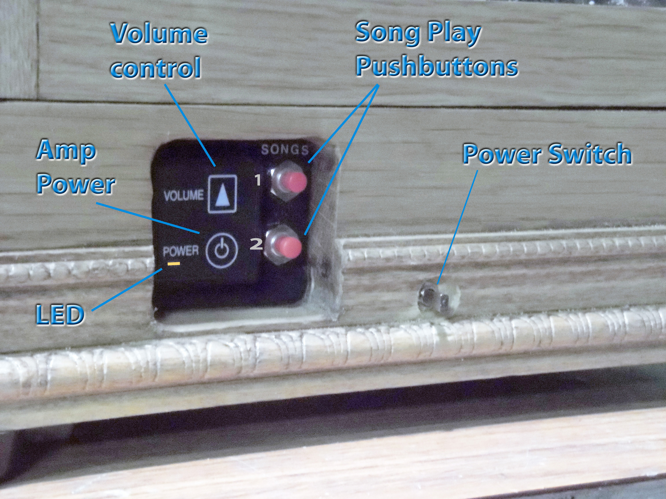

I'm forced to use 2 voltage dividers to drop it for my motor and USB. Not the greatest but it will work. My customer wants it by Monday the 8th. My fault for selling an R&D
item. My plan is to convert 3 more music boxes and test them till I'm satisfied with the
design then swap one of them for the my customer's original prototype. I would also like to create my own tactile switch overlay for the panel. The amplifier control panel is that design so all I would have to do is add that board to another board with my switches on it. My first trial would be to reverse print on a mylar transparency then back that up with another clear mylar panel. I'm now using those small push buttons that look cheap and I already had one fail testing the panel.(see picture). Well that's my plan but I wanted to thank you for all your help. You put me in touch with the buck converters that I didn't know existed.
