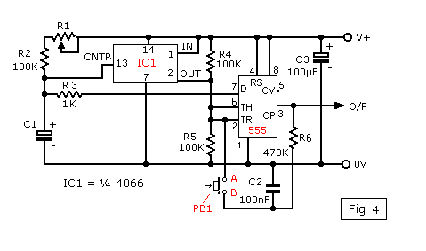

I have redesigned the 555 and built and tested it (Fig 4). I have added a spare switch from the 4066 package, and the rising voltage on C1 as it charges is now fed to the 4066 CNTR pin, and that switches pin6 to V+ to reset the 555 at the end of the timed period. That isolates R1/C1 from the bits around pins2 and 6 and allows C1 to charge correctly.
There is a difference in timing now, because originally C1 reached 2/3 V+ before resetting – now it is nearer 1/2V+. So it will be necessary to increase the value of C1.
I went back to my generic toggled 555 where the charge on C2 sets or resets the 555. It works faultlessly using a push button.

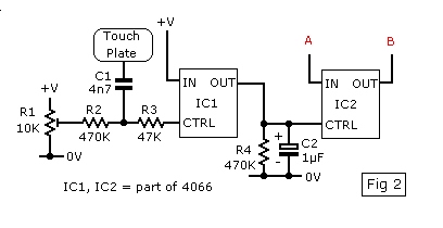

Now the touch plate circuit (Fig 2). I assume the devices Casdsys mentioned work on a change of charge, and that can either be –ve or +ve, whereas the plate considered here works on the 50Hz or 60Hz static that the body picks up from the mains supply. Its amplitude will be variable depending on local conditions, hence the variable pot I put in for sensitivity adjustment. I had to increase C2/R4 to integrate the signal, and found it would work OK (with a lot of electrical stuff operating near me) when R1 slider was at the bottom end (minimum sensitivity). Maximum sensitivity is just below the voltage at which the CNRL pin turns on the switch. Beyond that, of course, IC1 OUT will stay high and keep A switched to B.

I have put together the circuit - first the 555 timer, which works perfectly. Everything is spot on with it.
I then put together the touch plate circuit. Now, I have a couple of components that I did not have to hand - mainly the 1uF cap (C2). I played with putting some of the caps in parallel to increase (only had enough to get to 0.6uF). Interestingly, the circuit appeared to work slightly better without the cap in place.
But the key issue is that the circuit is very sensitive, even with R1 set to max. I suspect that may be because I have wired this up with bits of wire and floating components, so lots of long leads dangling around. Next step is to wire it into a vero board and see how it goes. I will also get a 1uf (and a 4n7) capacitor to make sure I am following what you have provided.
Should sensitivity remain too high, is it a case of changing the ratio on R2, R3? Or smoothing the line with a capacitor to ground? Just trying to get my head around the circuit.

[quote]But the key issue is that the circuit is very sensitive, even with R1 set to max.[/quote]
But the least sensitive position is with R1 set to its min position (so its wiper is at the 0V end of its travel). If it is still too sensitive then leave out R1, and reduce R2 and connect it to ground instead of to R1.
R3 makes no difference - it is there to protect the gate from being destroyed by too much static.
The 4n7 is not fussy. I only included it in case the charge on your body was negative, in which case IC1 would not switch on. 10nF or 22nF would be OK.
You can change C2 in value if you change R4 to suit. The time constant C2 (in microfarads) x R4 (in megohms) needs to be about 0.5sec. But the value of R4 needs to be no lower than 10K, otherwise the switch cannot cope with the extra current.

Now discard Fig 2 of my earlier circuit, and modify the circuit of Fig 4 like this:
1. Remove C2 and R6.
2. Replace R4 with an LDR. (LDR1).
3. Replace R5 with the other LDR (LDR2).
A sensor could be fixed either side of the mirror. With both sensors receiving the same amount if light, their resistances would be equal and so their junction at pins 2&6 would be about half the supply voltage. Under those conditions they will not affect the operation of the timer. If you now shade LDR1 from light its resistance will go up and pin2 voltage will fall, triggering the timer. Likewise, if you shade LDR2 the voltage on pin6 will go up - resetting the timer and turning off the light.
