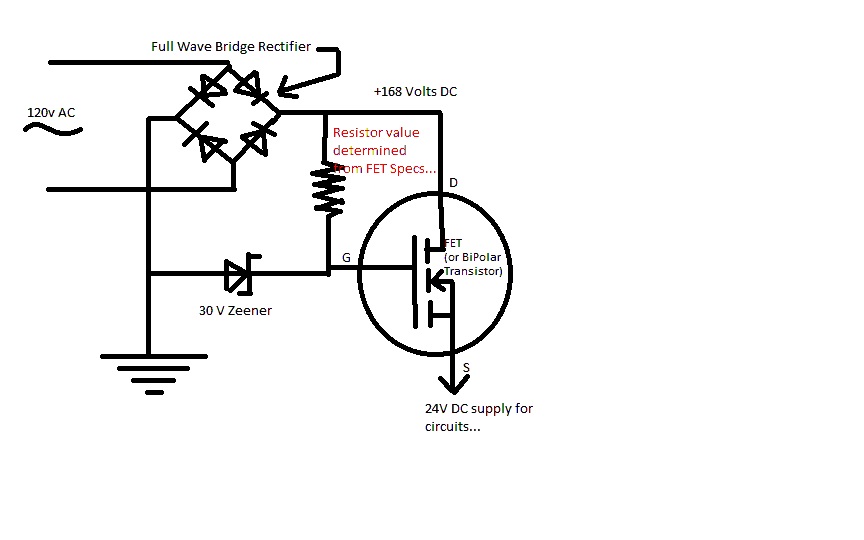

I want to use a FET or a Bi-Polar Transistor to drop the voltage but only after the bridge rectifier. the only thing attached to the mains is the bridge rectifier and 2 IC chips that are designed to work with mains voltage.
I am looking for a component that will allow only as much voltage to pass as I need based on the voltage present at the Gate or Base please see attached schem....
All I need help on is how to pick the FET or transistor. do I need to look at the voltage drop from 168 to 24 for the voltage? or just the 24V it is outputting at the 1.1A?
Power Supply Schem.jpg (51.66 KiB) Viewed 26983 times

Postby pebe » Tue Oct 11, 2011 7:44 am
You do not 'allow voltage to pass', you allow current to pass.
Regarding your circuit.
1. Your full wave rectifier is incorrectly drawn.
2. You cannot ground the output of a bridge rectifier fed from mains supply.
3. By dropping 100 volts at 1.1A your transistor would be dissipating 110watts !
This is a dangerous and impractical way to reduce voltage.
Postby I_Daniel » Tue Oct 11, 2011 9:48 am
[b]As Pebe says this is a dangerous and impractical design.[/b]
I personally think you should scrap the idea but will nevertheless give the following comment.
First the errors:
1. Your two diodes on the left hand side of the bridge rectifiers are drawn the wrong way round.
2. You don't have a smoothing capacitor after the bridge so you cannot get the peak value of about 170 volts.
3. Using a 30 Volt Zener will give you a power supply of about 29.4 Volt and not 24 Volt.
In a discrete component design I always recommend the use a 63 Volt capacitor across the Zener diode. This makes the power supply a slow start supply - no excessive surge thumps - and it also gives extra electronic smoothing. ( i.e MFD x Gain of FET or transistor)
The FET must be able to handle at least 200 Volts.
The power handling capability will at a minimum be the voltage drop across the FET times the required Amps. That is The FET or Transistor must drop almost 140 Volt across it so it is a case of 140 Volt x 1.1 Amps = 154 Watt minimum that the FET must handle and a large heatsink will thus also be required.
There are many small transformers commercially available of a reasonably small size that will give you 1 amp at 12 or 24 volts. Actually a 20-24 volt transformer will be ideal for the available DC voltage will be about 28 - 34 Volt which is ideal for using a 7824 IC Voltage regulator. The combined cost of the IC Regulator and the transformer will in all probability cost less than the very high power FET or Transistor that you will need.

Postby Logic1020 » Tue Oct 11, 2011 9:07 pm
I_Daniel,
Thank you for the help!! I would have never thought of a cap across the Zener...
I am space limited to a 4" circle and I have about 80% board coverage now, by removing the large resistors I can get almost 50% of my 4 inch board but that is not near enough room for any 120 to 24 volt @ 1 amp transformers I can find. If I have missed one, please point it out, and better yet, if there is a better way to drop over 100V please let me know.
As far as the power handling requirements of the FET, the one I linked to in my original post ([url]http://www.fairchildsemi.com/ds/FD%2FFDA38N30.pdf[/url]) is rated at 300v, 38A, and 312W. It's kind of hard to read but Figure 9. Maximum Safe Operating Area looks like 140V @1.1A is well within the DC region. They are $3.83 each from Mouser and I already have 4 from another project.
Thanks!

Postby I_Daniel » Tue Oct 11, 2011 10:14 pm
If you have a broken down PC power supply then you can use one of the caps from it for smoothing. They are usually 200 Volt and 220 Mfd.
Please remember not to earth your circuit. I assume the earth shown on you schematic is actually the negative line and not an earth connection.
I have seen circuits such as yours especially if you consider a PC power supply, printers and laptop power supplies. Your circuit should work with the FET you have mentioned. Also remember the Heatsink is a must.
I am too much of a scary cat to use such a circuit but switch mode power supplies appear to have taken over in most equipment that used transformers. Of course these power supplies do give isolation from the mains. Oh and remember to put a fuse in the circuit.
From the 110 Volt mains I see you are in America. In South Africa, where I am, we have a much more dangerous voltage 230 Volts. This also means I cannot help you much with where to buy a small transformer. However I see people are many times referring others to Radio Shack for transformer and spares.
