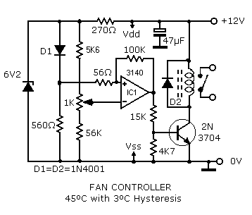

Postby pebe » Wed Sep 21, 2011 2:00 pm
If you want something that is a bit more sensitive to temperature changes, then you could use this circuit.
It will switch the fan motor on and off within 1.5degrees of the setting.
45ºC Fan Controller.GIF (4.91 KiB) Viewed 16576 times

[quote="pebe"] If you want something that is a bit more sensitive to temperature changes, then you could use this circuit.
It will switch the fan motor on and off within 1.5degrees of the setting. [/quote]
Haha that would do the trick, just needs to be really basic though and nothing too special, I'll try some different things out and may incorporate this circuit if I need too, thanks for the help.

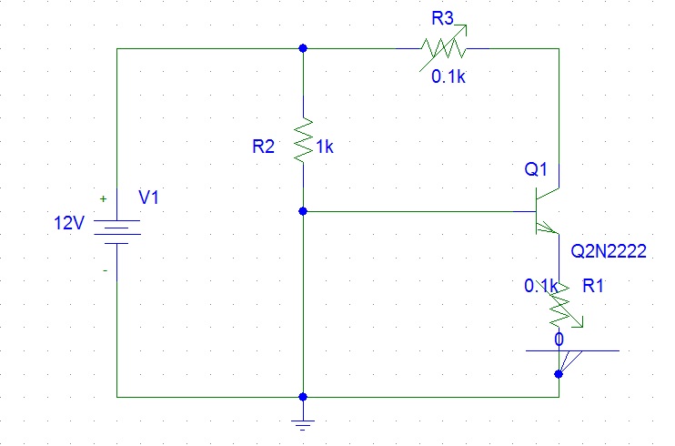

Postby BlakeH » Thu Sep 22, 2011 9:53 am
I've created a schematic, probably wrong with my experience,
will something similar to this actually work?
The program i use (Pspice) doesn't have a symbol for a thermistor so R3 is representing a thermistor and the viewpoint in the lower right hand corner shows where the motor should be.
BlakeH
Joined: Thu Aug 18, 2011 2:28 am
Postby I_Daniel » Thu Sep 22, 2011 10:54 am
I will check it and give comment a bit later; but first could you tell me how much current the DC motor draws. Your schematic does not indicate where the motor will fit into the circuit.

Postby I_Daniel » Thu Sep 22, 2011 11:19 am
Both schematics have reappeared and vanished again but I had time to look at yours.
The link you show from base to the negative supply must be replaced with a variable resistor. As it is now the transistor bias is incorrect since it is held at ground potential and the transistor will thus never conduct.
I_Daniel
Posts: 93
Location: Pretoria
Postby I_Daniel » Sat Sep 24, 2011 9:41 am
More corrected comment _
The thermistor must be part of the base bias network and not as the collector load.
the bias network is thus R3,R2 - in series from vss+ to Q1 base and then a variable resistor from R2/Q1 Base to vss-
