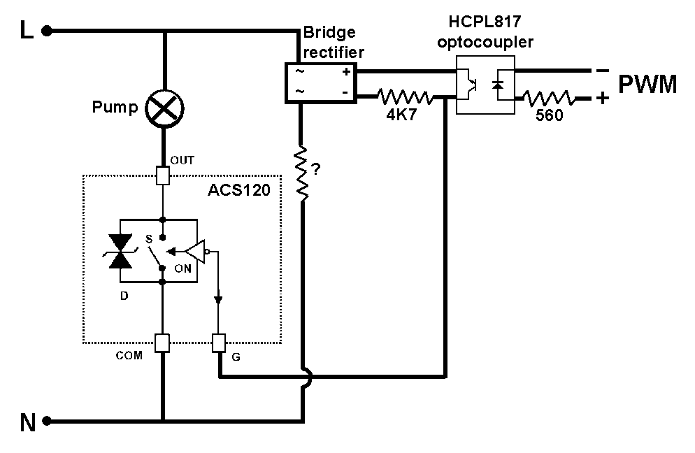

I am pretty lost on interfacing a logic signal with AC, but would something along these lines be possible?
Circuit idea

Postby pebe » Mon Aug 22, 2011 9:35 am
Hi Bhante,
Page 4/11 of your link to the ST switch does not give a full description of how the micro is powered. I remember when I was using the ST62 series of micros that they gave an application note for connecting one to a triac for power conrtol, such as you need. It is their AN392/0591. If you cannot find it I could send you a copy of the circuit.
To PWM a triac I think you need to sense the zero voltage mains crossover point and put a delay in from there (each half cycle) before putting a voltage on the gate to fire the triac.
The original circuit was for a lamp dimmer with 'brighter' and 'dimmer' push buttons, but opto isolators could be used.

Postby pebe » Mon Aug 22, 2011 4:34 pm
I haven't got the separate AN392. My copy is in 9 pages at the end of the 'ST6210/6215/6220/6225 datebook' published by SGS-Thomson.
It is probably the same as yours. Does yours show an ST6210 firing a BTA-08-600SW triac?

Postby pebe » Tue Aug 23, 2011 9:10 am
Your resistive power load can be controlled either by phase delay or by PWM. But I presume you have some reason wanting only PWM control for the pump.
The AN shows how to get a 5V supply from the 200V supply by using a diode pump. You could use that to get 5V below Neutral and then use your optocoupler to drive the gate of the ACS120 negative to trigger it on.

Postby pebe » Tue Aug 23, 2011 7:03 pm
[quote]Ah, is that what it is? I tried googling for diode pump but after a couple of hours I am only a little bit the wiser - I couldn't find anything powering a low-voltage circuit from the mains. Only audio circuits, voltage multipliers, and various other things. What I do notice is that in the bottom left corner of both Fig 2 and Fig 4 of the AN there is something looking a bit similar to the voltage doubler circuits I found. [/quote]
It is essentially a voltage doubler circuit, but using a zener diode as one of the diodes ensures the maximum voltage across the reservoir cap is limited to the zener diode voltage.
[quote]Nevertheless it does not explain why the current is not shorted from Live through the Vdd pin of ST62 via the Vss pin to ground! Also would I be right in believing that this circuit only works for the micro that is embedded and "floating with mains" in some way (I don't yet understand what that might mean) - and not where I have the Arduino powered from USB? Also is it specific to the ST62 that it can be powered in this way?[/quote]
The 0V shown beneath a bar is not a ground symbol. The bar is just indicating that all the points marked ‘0V’ are connected to the same wire. In this case the circuit generates a –5V rail. By reversing the diode and the zener it can generate a +5V rail. And it can be wired so that the voltage is relative to either the Live or neutral wires. If you like we can go through the circuit.
The use of such a circuit is not limited to the ST62. It can be used for a PIC or a 555, or whatever
[quote]The typical application diagram in the ACS120 datasheet implies a much simpler way of powering the microprocessor and does not (that I could find) say anything about powering the micro from a diode pump.[/quote]
The ACS120 datasheet does not give a –5V supply, merely a label for it to be attached. It is left for the user to provide the supply.

Postby pebe » Wed Aug 24, 2011 6:01 pm
Regarding the ground symbol in your copy of the AN, don’t ground that point. The symbol used originally in the ST6200 series databook is the correct one as it uses a bar to indicate a common 0V bus. I don’t know why ST changed it, because there is 220VAC at that point. So the use of a ground symbol is wrong and potentially dangerous. I am surprised no one has taken ST to task over it.
Your Arduino has to connect to a PC, so the only way you can fire the triac would be to use an optocoupler. You can power the Arduino from a discrete PS, and use the –5V diode pump to switch the triac.
But before I can suggest anything, could we clear up a point about PWM? A triac (or the SSR you mention) cannot be turned off during a half cycle – it has to wait for the next zero current crossover. So can I assume that your PWM allows the triac to fire for a number of half cycles and then inhibits a number of them?
